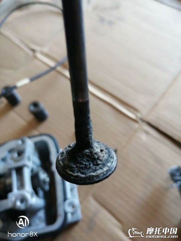

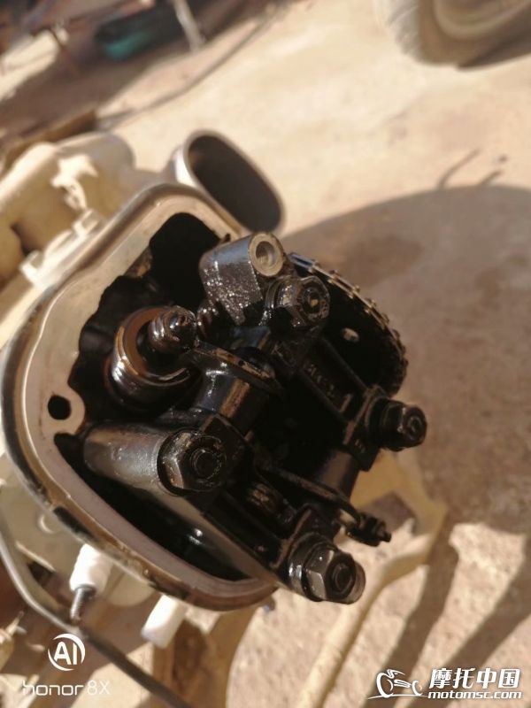

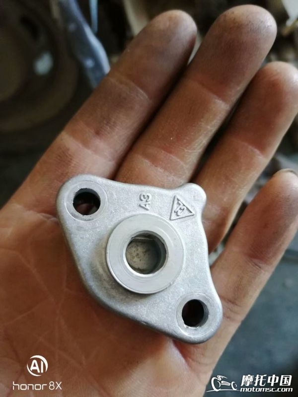

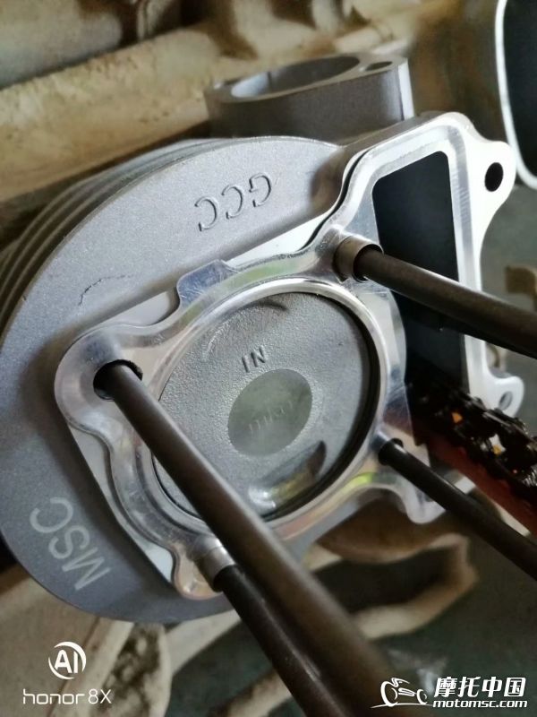

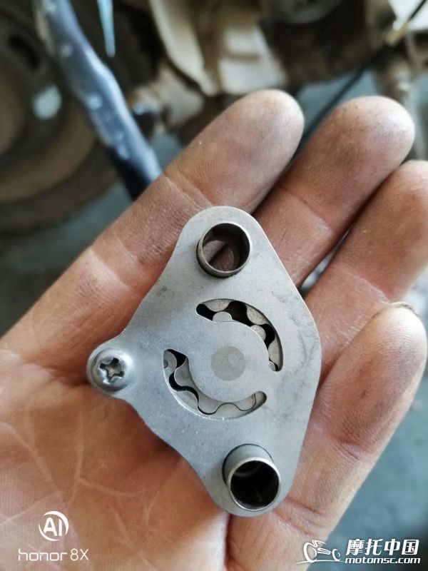

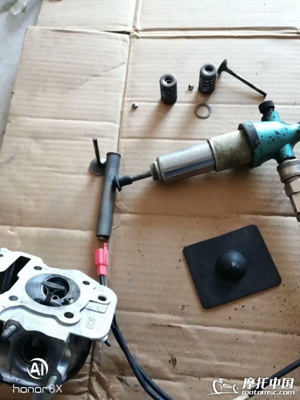

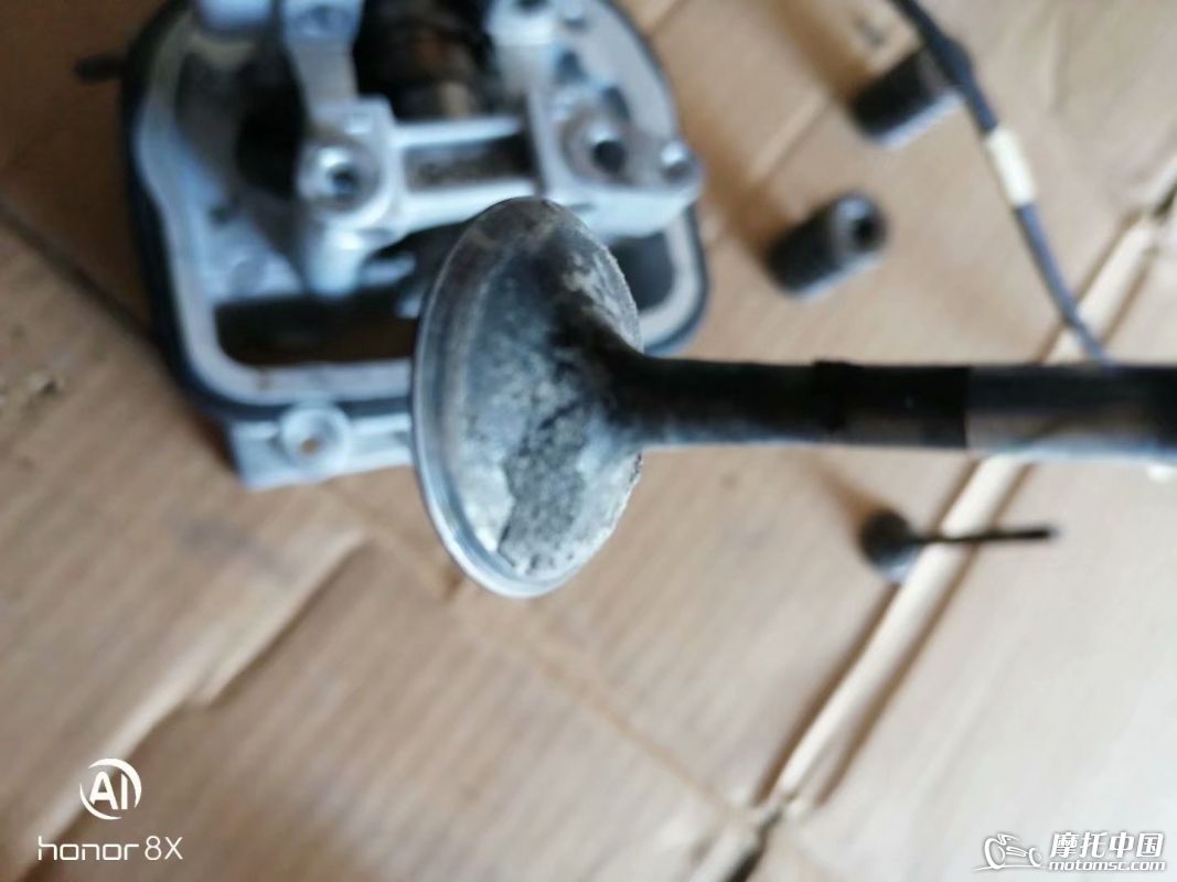

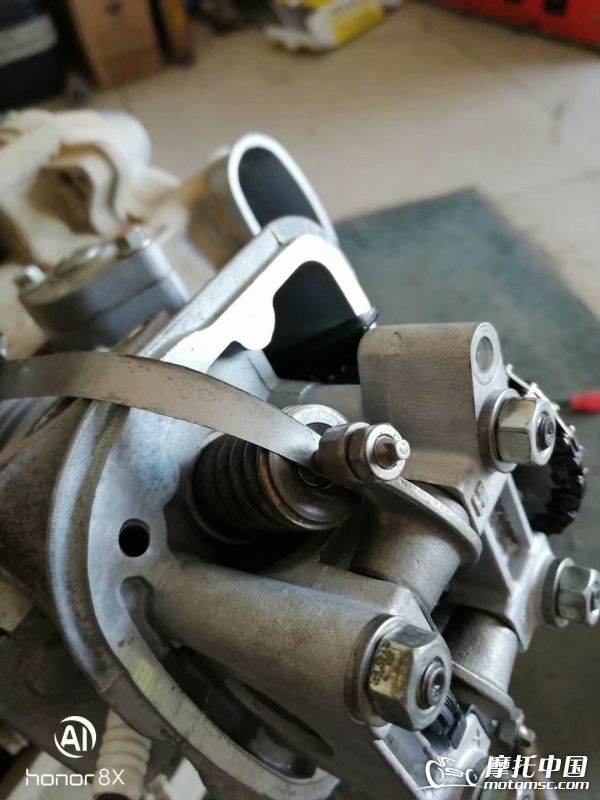

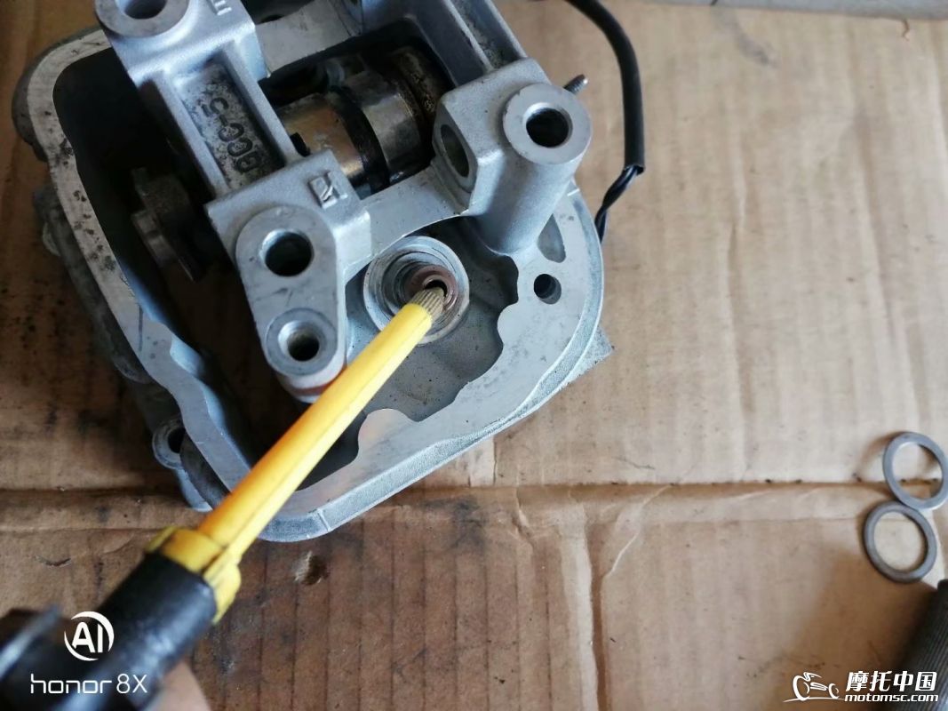

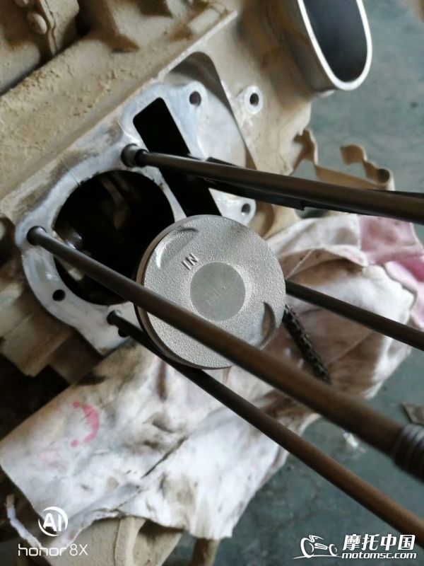

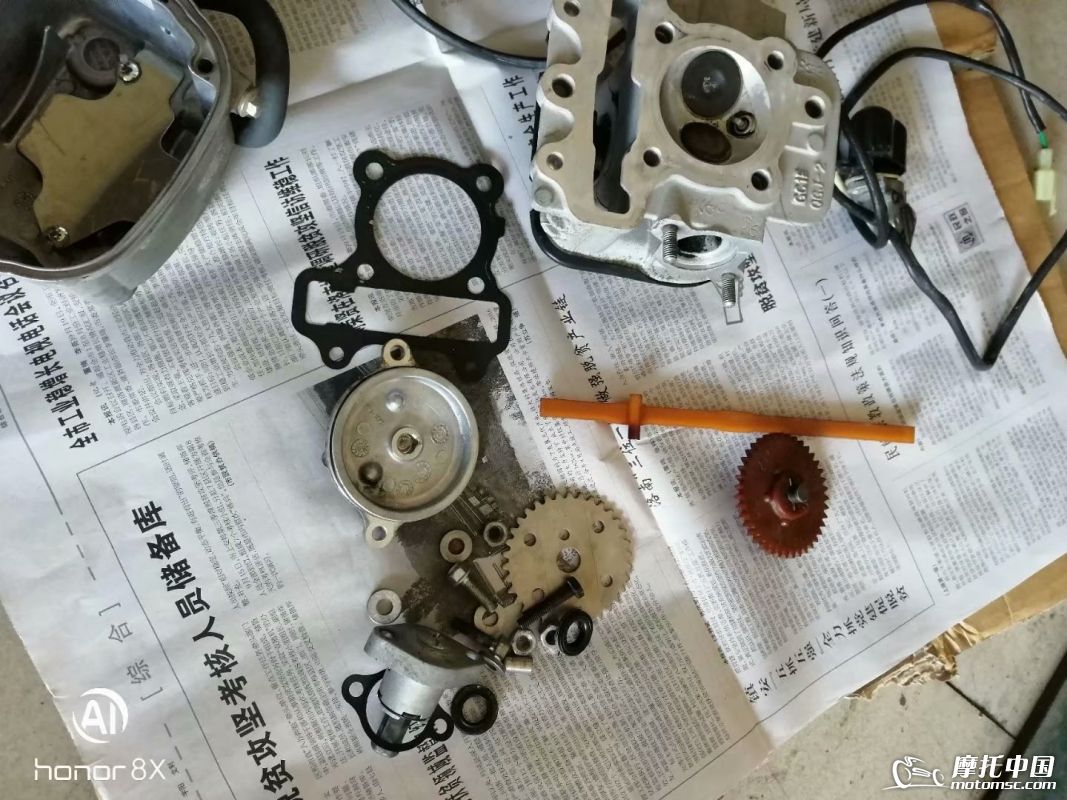

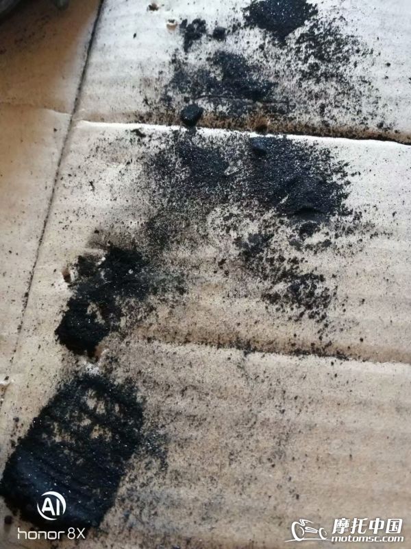

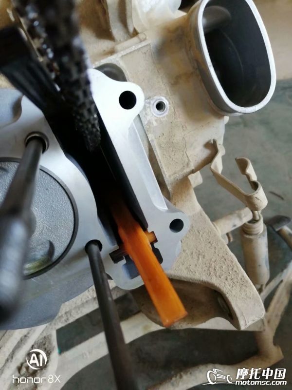

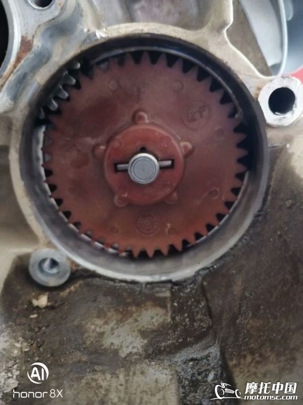

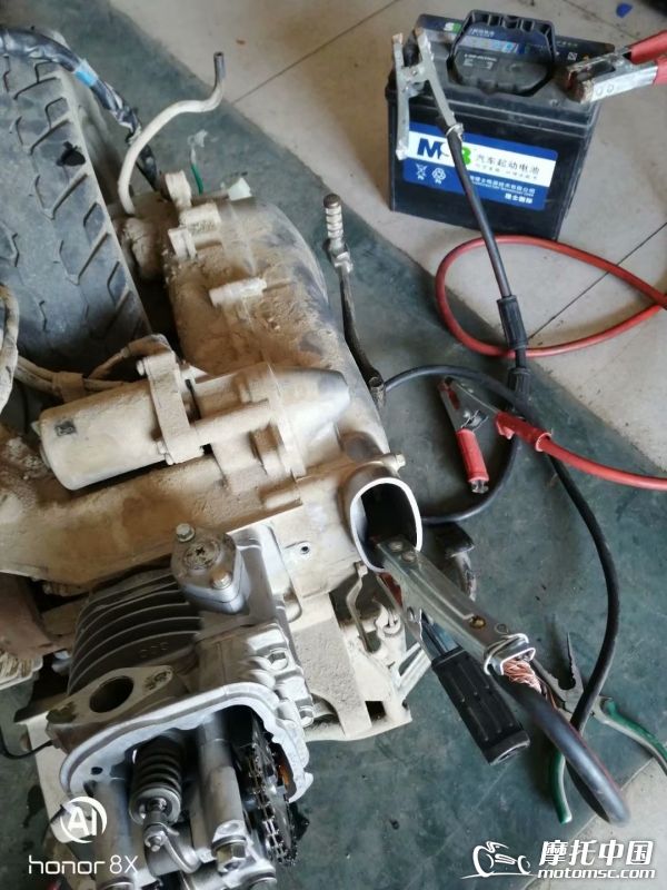

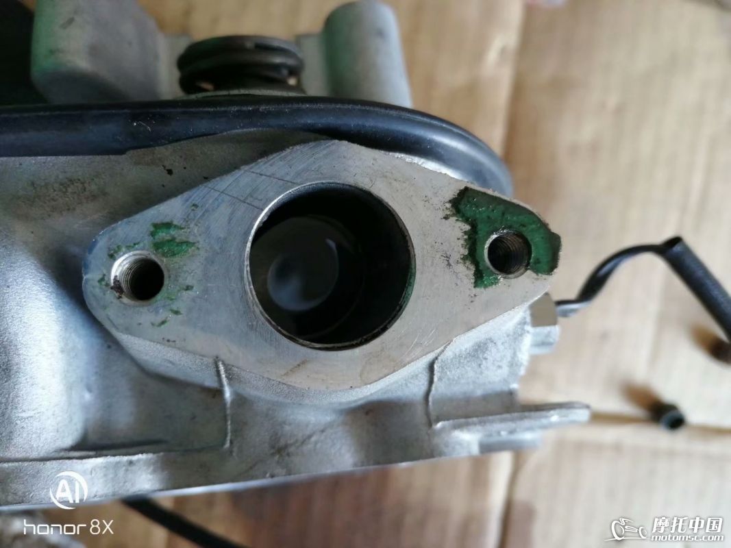

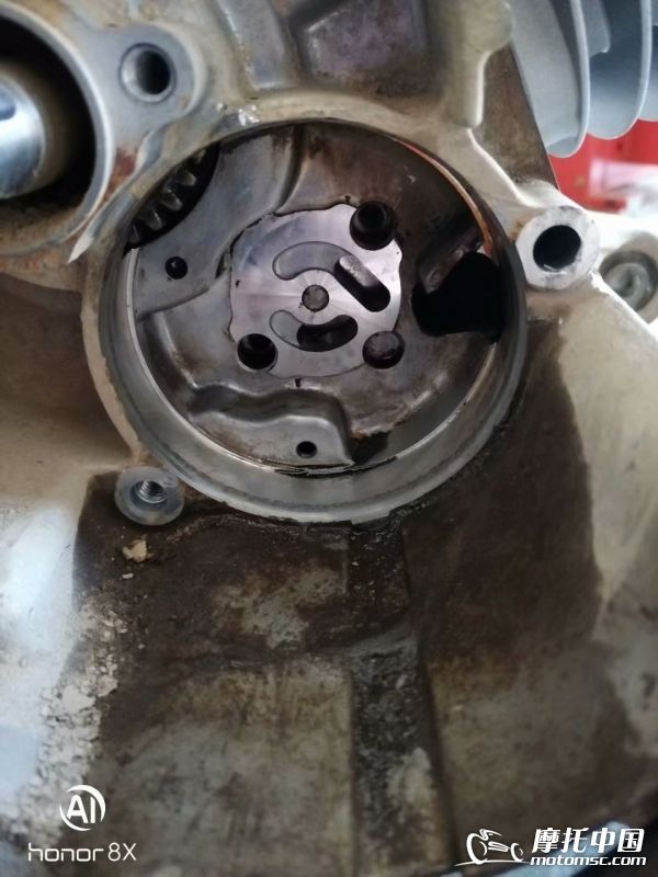

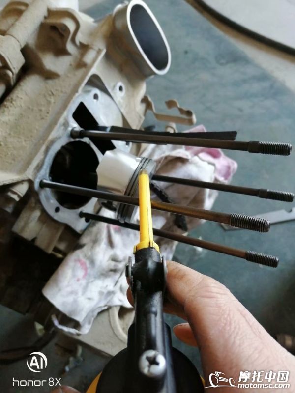

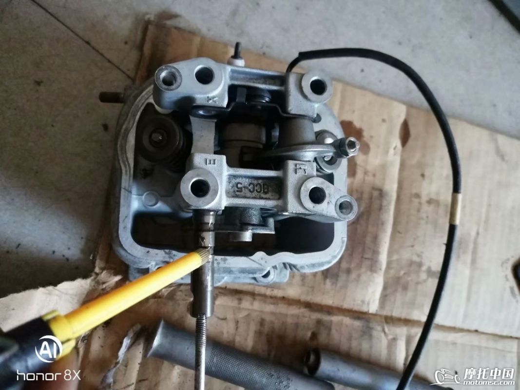

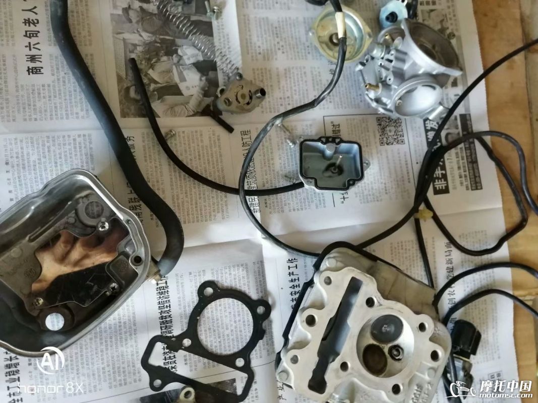

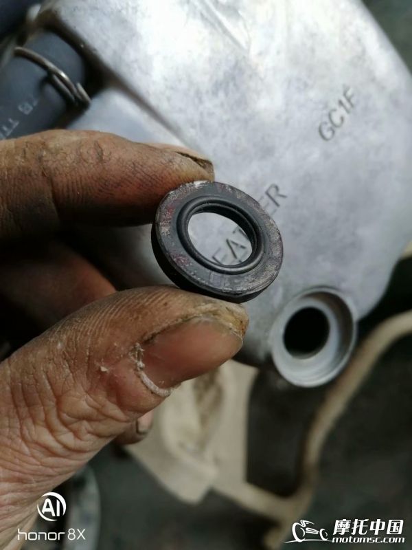

        前几天一位老顾客到店里来说他的小公主100可能拉缸了,让线给看看,启动车辆看到排气管有很大的蓝烟,车主说那你给看着修吧,什么不行就换就行了,总之要把车子修好。那就拆吧,打开缸盖看到发动机里面脏的已经不成样子了 9351e01da243f22409486bd57c96afb4_dCEAAAAAAAAA&bo=OASgBQAAAAAKB7I!&rf=viewer_4.jpg 。这车一般机油泵容易磨损,也是重点检查对象,拆下来看到工厂已经改进了,工厂还是很用心的。从化油器的进气侧看到灰尘很多,分解化油器和缸头什么的一块清洗 8c673c58ad61f008ec309e17bf238301_dBEAAAAAAAAA&bo=oAU4BAAAAAAKJ5I!&rf=viewer_4.jpg 45e1d099a6dc18973b78c8ca06380890_dB0AAAAAAAAA&bo=oAU4BAAAAAAKJ5I!&rf=viewer_4.jpg 。首先检查曲轴大头间隙正常,清理缸体垫片,装好活塞和环,缸体和缸体垫片 6071a8c4f2e5fbb4740b0df25ca5fe74_dCEAAAAAAAAA&bo=OASgBQAAAAAKF6I!&rf=viewer_4.jpg af87e7774ab5ca1e26f9fdd9e46116f7_dCMAAAAAAAAA&bo=OASgBQAAAAAKF6I!&rf=viewer_4.jpg ,拆开气门发现进气门磨损严重 ba6ec0967828d8d0c1cebc9f85803e13_dBkAAAAAAAAA&bo=oAU4BAAAAAAKF6I!&rf=viewer_4.jpg ,排气门积碳很多 f30c0e6ddcde1d8084d4515747a96931_dCEBAAAAAAAA&bo=OASgBQAAAAAKF6I!&rf=viewer_4.jpg ,清理进气道和排气道里边积碳后 921e920d87e78b5886d5b33cecf47064_dCIBAAAAAAAA&bo=OASgBQAAAAAKJ5I!&rf=viewer_4.jpg 直接换气门用新气门测试导管的磨损情况,发现配合间隙良好,换气门必须磨气门 0f48a56f0661c9f4b6e1bbd9e7592526_dCEBAAAAAAAA&bo=OASgBQAAAAAKF6I!&rf=viewer_4.jpg ,一般磨气门都分两到三次磨好,避免磨的过度。测试漏气是不能少的一到工序 0aae107817940383e176b7c7e87b7ec8_dBoAAAAAAAAA&bo=oAU4BAAAAAAKF6I!&rf=viewer_4.jpg 。接下来装气门油封和气门 b2c96532b99bbf5ba3c8ec555a628157_dCYAAAAAAAAA&bo=oAU4BAAAAAAKF6I!&rf=viewer_4.jpg 01e2381049dea0ddc05ae64d34628938_dBoAAAAAAAAA&bo=oAU4BAAAAAAKF6I!&rf=viewer_4.jpg ,检查凸轮摇臂磨损量很小。装好缸头垫和定位销 6f901da5beca273330c74c192279538b_dBwAAAAAAAAA&bo=OASgBQAAAAAKF6I!&rf=viewer_4.jpg 7f84ca22fbed606cafb4d990e1a05c03_dBoAAAAAAAAA&bo=OASgBQAAAAAKF6I!&rf=viewer_4.jpg 6b9dbe403f5de352754fd4eabb5060cc_dB8AAAAAAAAA&bo=OASgBQAAAAAKF6I!&rf=viewer_4.jpg ,。装上缸头,用扭力扳手上好四颗缸头固定螺丝和边上两颗定位螺丝到规定力矩 79e166584527d12e6d0ecea9e415adb6_dBcAAAAAAAAA&bo=OASgBQAAAAAKF6I!&rf=viewer_4.jpg 。检查油泵和油泵齿轮的磨损情况,磨损比较小 03d503cb29193b1d4e5fd626299bf3d7_dEAAAAAAAAAA&bo=OASgBQAAAAAKF6I!&rf=viewer_4.jpg ,装好油泵,泵体上有两颗定位销 504533876881c8a43bc9faa62322a7f8_dBoAAAAAAAAA&bo=OASgBQAAAAAKF6I!&rf=viewer_4.jpg e72ce9822f15855cf9e3ca1557ab4b4d_dCEBAAAAAAAA&bo=OASgBQAAAAAKF6I!&rf=viewer_4.jpg ,装的时候要注意别忘了。装好磁电机,再装正时齿,同样用扭力扳手上到规定力矩,调整气门间隙到规定值 8cc448791ec01d5e56899bd4ee8defb7_dBoAAAAAAAAA&bo=OASgBQAAAAAKF6I!&rf=viewer_4.jpg ,清理机油滤网 0dae20284885be23eaa4c4caa3d4a1a4_dBcAAAAAAAAA&bo=OASgBQAAAAAKF6I!&rf=viewer_4.jpg ,加机油到标准值,我有个习惯一般把发动机整体拆下来的车子,装好后用电池接在马达让它转几十秒 c762f43804cb63f2ba912e1e965c22e7_dBMAAAAAAAAA&bo=OASgBQAAAAAKF6I!&rf=viewer_4.jpg ,看一下机油泵的工作情况。机油泵工作正常。装复缸盖,两颗螺丝上的密封垫片是有反正的,打有UP一面朝向车头一测 271ad846bab379c9d50f5f1089178e54_dCkAAAAAAAAA&bo=OASgBQAAAAAKF6I!&rf=viewer_4.jpg ,别装反了。装好发动机外壳。更换新的火花塞和空滤芯,发动机装车启动一枪着车,声音完美。

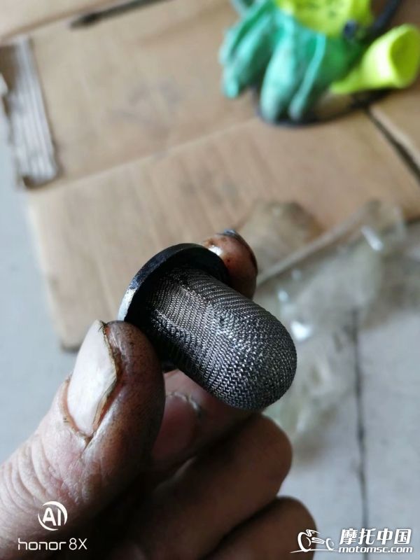

    发表于 2019-1-20 00:55:07 指尖摩托手机 | 显示全部楼层
    这个机油滤网是装在什么地方   我在右边放机油时怎么没发现?

     楼主| 发表于 2019-1-27 22:52:00 | 显示全部楼层
    在起动杆那边的箱体上
